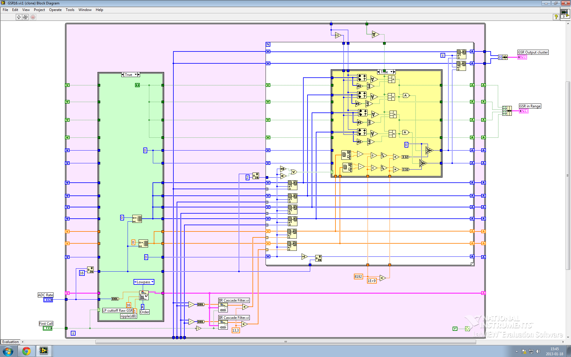

Can you please help us in decoding the .vi GSR object to get the real GSR value in correct voltage measure. I'm afraid we are a bit unexperianced with LabView, but we can write regular code.
Picture is related. Its GSR object from LabView
What we have are the values pasted in the above post, and we need them corrected in the correct voltage measure using the same ActiView GSR16.vi module that corrects for these values (posted in the picture).
//Petar
//Petar
- sourcecode.png (152.38 KiB) Viewed 54385 times

Can you please answer the previous post question, which boils down to: Which value(s) to regard as a current GSR value, during the 16Hz excitation current half-wave?
Re: Weird GSR data
My LabVIEW code explains it better than words, Coen (BioSemi)
