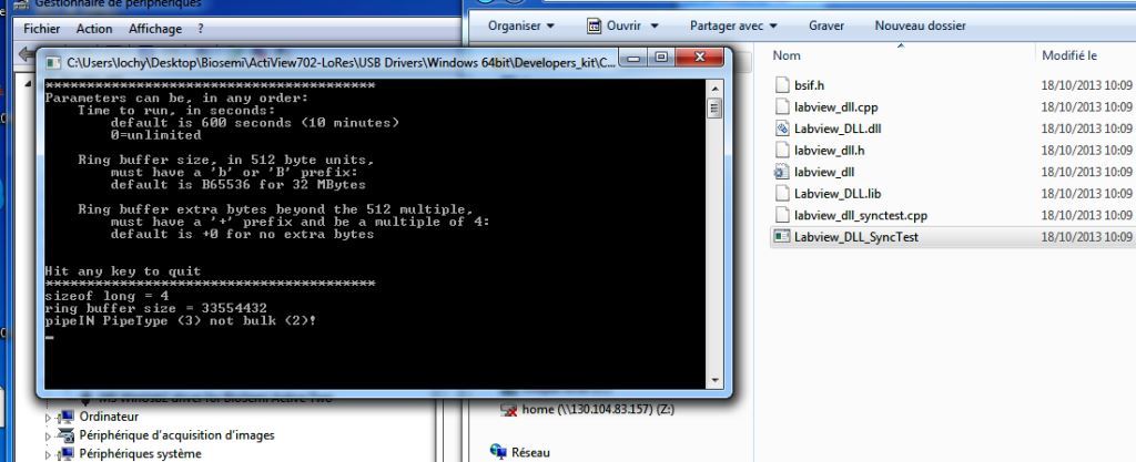

on W7 64 bits I reinstalled the most recent driver, I replaced the _dll file in ActiView and I tried several versions. I ran SyncTest and I send you in attachment the message I got. The optical fiber looks to work properly ("data" light is on on the USB2 receiver).

That's usefull info. Your USB receiver has the very first firmware version (2004) and needs an upgrade to work properly with the new driver. Please sent you receiver to us for an upgrade. Also see viewtopic.php?f=2&t=597
