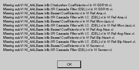

Dear all,
I am trying to run ActiView on Linux (either Ubuntu 12.10 32 bit or Ubuntu 14.04 64 bit), but I always get the same error:
libmkl_lapack64.so: cannot open shared object file: No such file or directory
If I press OK, I get other error messages regarding LabVIEW resources not found:
- NI_AALBase.lvlib: IIR Cascade Filter (DBL).vi
- NI_AALBase.lvlib: Bessel Coefficients.vi
- NI_AALBase.lvlib: IIR Cascade Filter with I.C. (DBL).vi
- NI_AALBase.lvlib: Chebyshev Coefficients.vi
And then a final error message containing saying that those resources are missing in VI GSR16.vi, VI Ref-Ana.vi, VI Ref-Mon-Jazz.vi, VI Ref-Avg-New.vi, VI Ref-Bip-New4.vi and VI Sensor.vi.
The window of ActiView is eventually showed, but the buttons to start/stop the system are not working.
I have downloaded the LabView Runtime Engine 8.5 from here (http://www.ni.com/download/labview-run- ... .5/868/en/) since the link on BioSemi website is not working anymore.
Also, I have downloaded and installed USB driver for linux and ActiView for Linux. My LD_LIBRARY_PATH is set to /usr/local/lib/LabVIEW-8.5.
Is there anyone that know how to solve this problem?
Davide

- Set of errors
- errors.png (7.35 KiB) Viewed 108138 times
Re: ActiView on Linux: file missing
The error is caused because the basic filter VIs are missing from the RTE version your are using (apparently, this RTE only contains LabVIEW BASE, not FULL, we have also seen this on RTEs for Mac).
We will compile a new Linux executable with included filter libraries.
