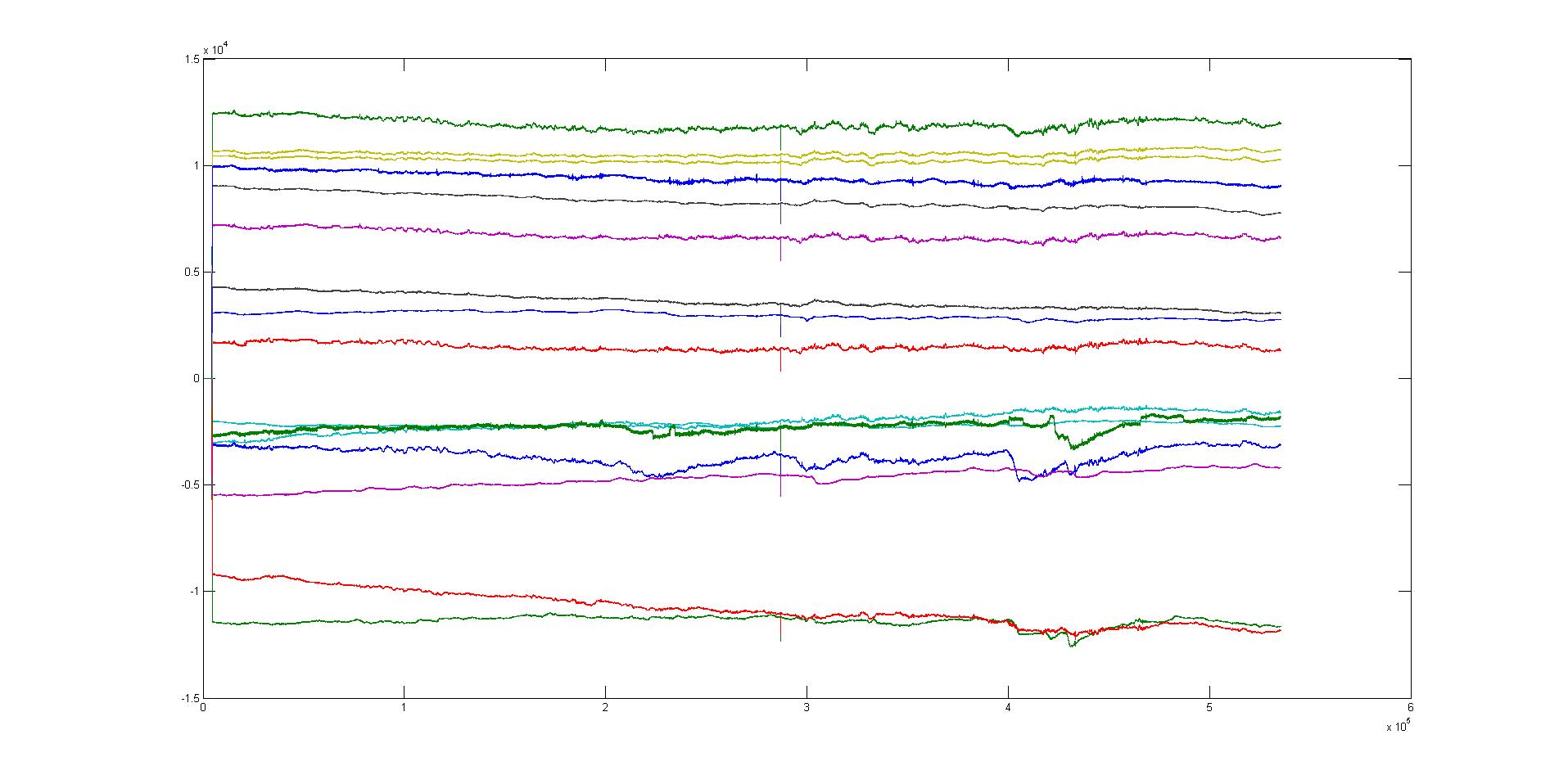

After that every channel start to record correctly, but there is a huge offset in every electrode. I attach a picture so you can see it. Basically each electrode has an offset between -1000 and 1000 uV and each of them is different. Why is that? I am recording incorrectly the data?

Data should start immediately, compare with acquisition with ActiView. The initial stream of 256 values must be caused by a bug in your acquisition program probably displaying the wrong (empty) channels for the first seconds.
The offsets are normal, it is a DC amplifier, see viewtopic.php?f=4&t=58 see and viewtopic.php?f=2&t=347 and viewtopic.php?t=56
