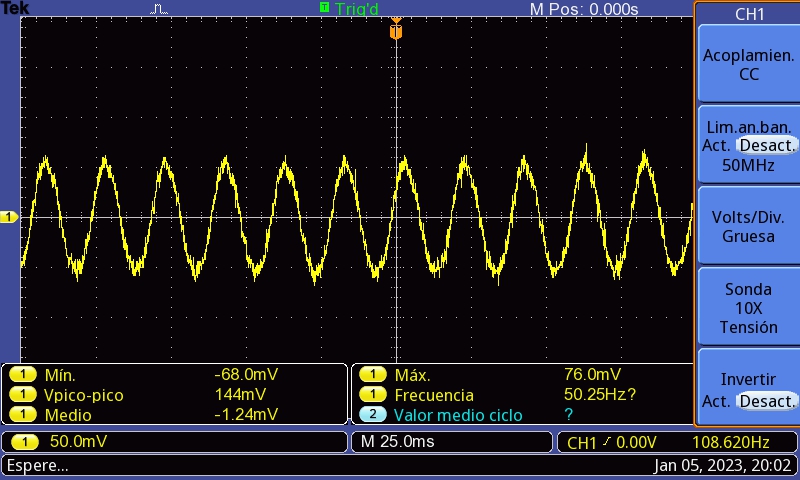

With my team, we are trying to solve a problem that involves a Biosemi AIB Analog Input, a Kistler DAQ and a Kistler Multicomponent Force Plate.

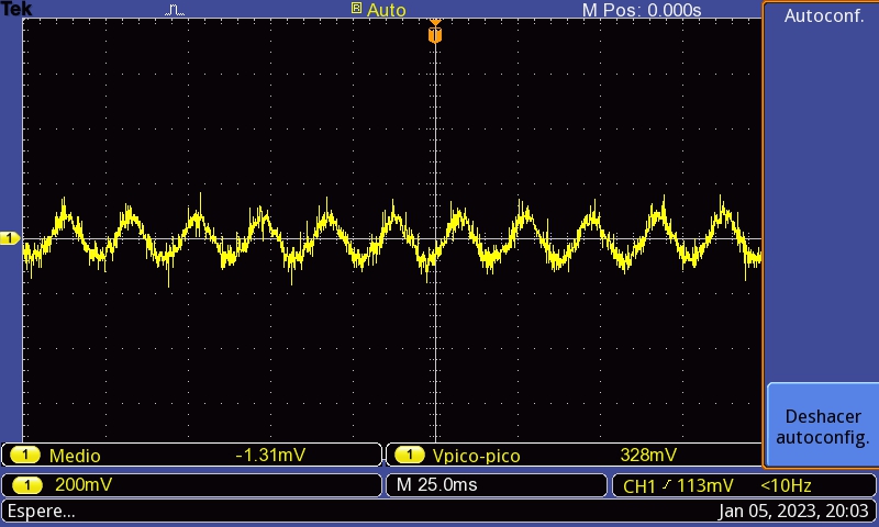

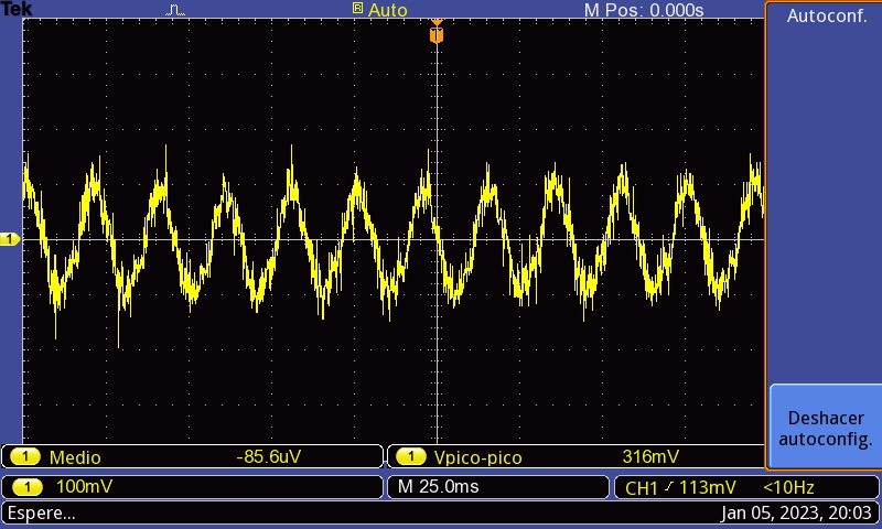

Specifically with the Biosemi AIB, we connected the input to an oscilloscope (ground to pin 37 and probe to channel pins as stated in this page https://www.biosemi.com/faq/pin_connections_aib.htm) and get the next images:
If we are not wrong, and since those are Inputs, we should read high impedance and not a sinusoidal wave of not negligible peak-to-peak value of roughly 50 Hz. Is this the expected behavior of the Analog Input of an AIB? Or are we dealing with a defective device?

50 Hz pickup is normal when measuring on an unconnected (floating) high impedance AIB input.
Connect the analog outputs of your Kistler Multicomponent Force Plate to the AIB inputs and inspect the signals in ActiView. You do not need the Kistler DAQ, the BioSemi AIB is the Data Acquisition System in this case.
