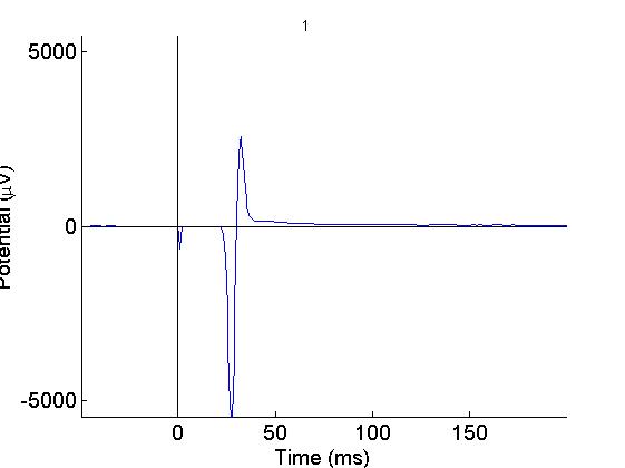

The MEPs currently recorded look a little strange. If you look at the attachment of what a normal MEP should look like (normal_MEP.jpg) and compare it to the MEPs I have been getting (myMEP.jpg), there are some differences. For example, the waves that should be present just after the MEP are entirely absent in my MEP. This seems like it might be an issue with filtering.
Finally, after some TMS pulses in the raw data, the signal also struggles to return to baseline following the TMS pulse artefact. I wonder if this is also likely to be a product of amplifier settings, or some kind of interaction between the TMS pulse and the amplifier?

- My MEP
- myMEP.jpg (14.34 KiB) Viewed 1301415 times
- Normal MEP
- normal_MEP.jpg (23.2 KiB) Viewed 1301415 times

ActiceTwo does not show the filter ringing problem seen in the "normal" MEP. For filter info, see viewtopic.php?f=1&t=351
ActiveTwo is a DC system, return to baseline after overload takes 5 samples (due to FIR filter in ADC). Increased baseline return time after (several) TMS pulses is almost surely caused by electrode polarization (provided Common Mode remains in range during the pulse, blue LED should remain ON).

A higher sample rate does indeed result in faster pulse response. This will mean faster return to baseline in practical measurements provided that the amplifier response is the limiting factor. This is usually not the case with TMS, where the return to baseline speed is usually determined by electrode polarization effects (see TMS threads). So changing the sample rate won't have an effect.
