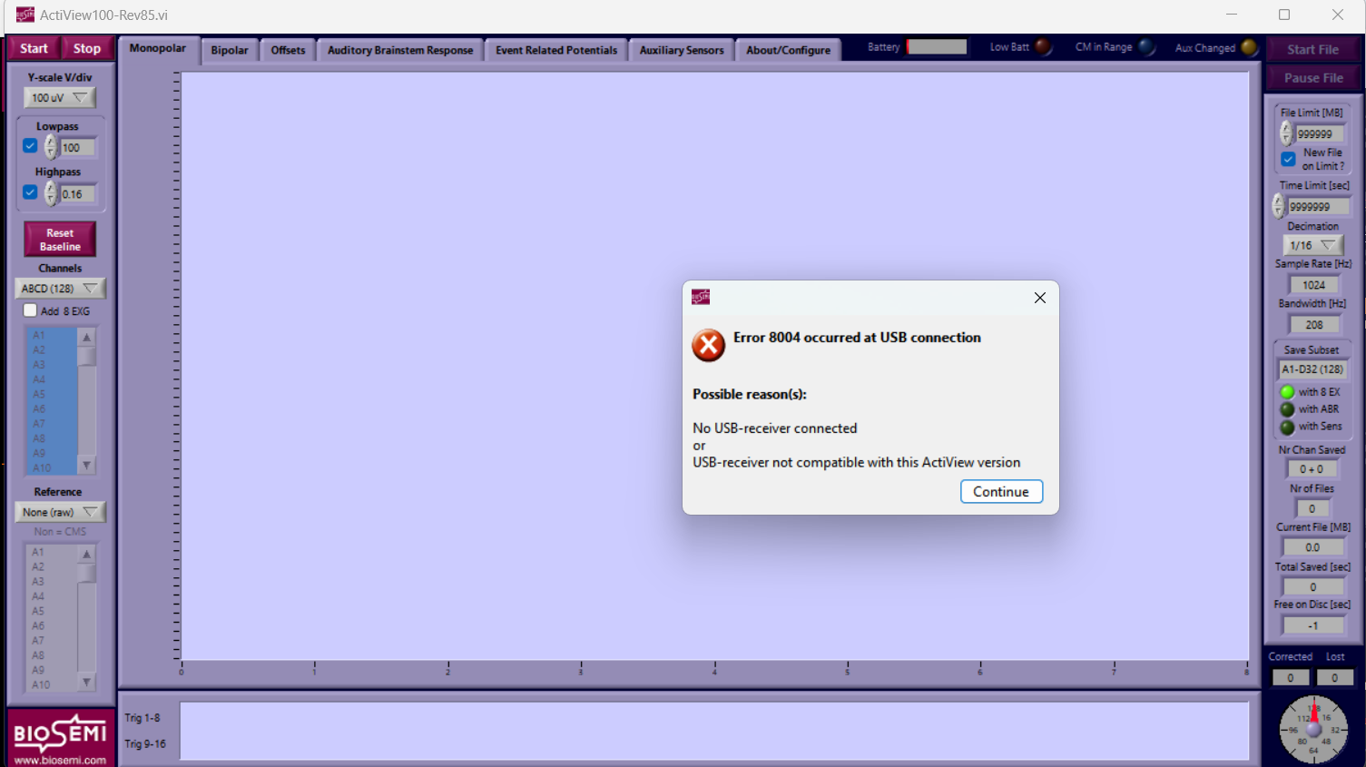

Our team just have Biosemi Active2 upgraded to Active2.5.
However, ActiView10 software got the error 8004 of 'USB-receiver not compatible with this ActiView version'.
We tried with the ActiView9.02 and it works, so the problem should be the incompatibility between USB2 receiver and ActiView10.
We are trying to use Active3 and Active2.5 for our hyperscanning study and hyperscanning use the ActiView10.
I attached the error we encountered with ActiView10 below.
Could any one have solution for this?
ActiView10 not working with USB2 receiver with Firmware4.0

Re: ActiView10 not working with USB2 receiver with Firmware4.0
ActiveTwo (Mk2 and Mk2.5) only works with ActiView 9.xx
ActiveThree only works with ActiView 10.x
Please contact your local BioSemi represenative for ActiView 9.03 that allows hypersampling:
Master: ActiveThree with ActiView 10.0 on 16 kHz sample rate
Slave: ActiveTwo with ActiView 9.03 on 2 kHz sample rate (speedmode 4)
