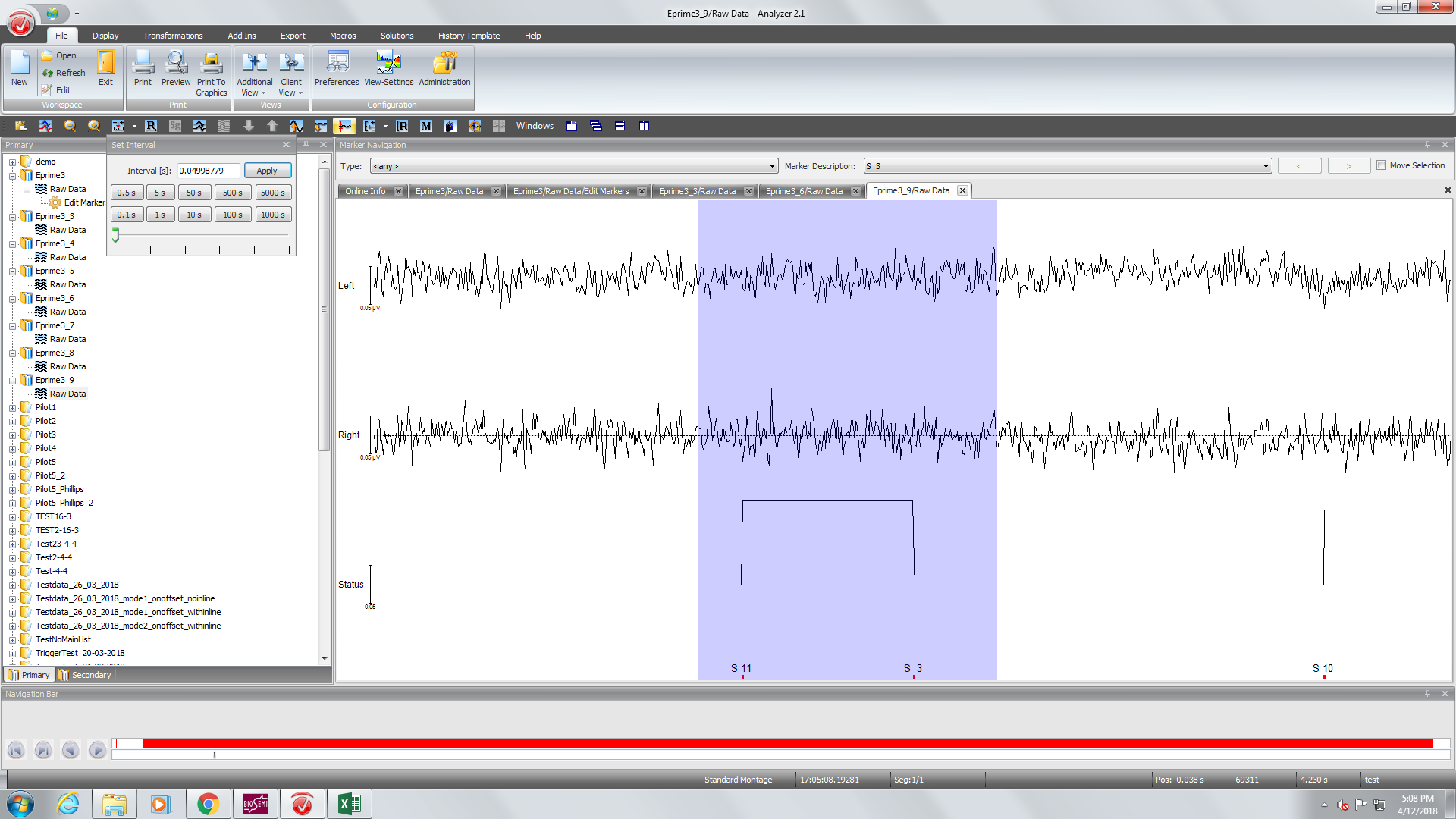

recently we have acquired the ABR cord and input and have been able to record decent ABRs using a stimulus with fixed intensity and a single triggercode (sent synchronously with the click onset). We are now also able to present clicks with different amplitudes and different triggercodes. However, somehow we get additional triggers when checking marker quantities using Brain Vision Analyzer (BVA). The additional trigger codes (3 in screenshot) can often be found at the same time as a marker we actually want (10 or 11) or at the down slope a coupe of samples later (see attached picture). We always send a 0 after a stimulus trigger (e.g. 10, integer) and have a couple of milliseconds in between the 0 trigger and the next stimulus trigger. Using our setup (see below), trigger lines 9-16 are always high (rainbow colors in ActiABR) and stimulus triggers show up in triggerlines 1-8 (should all 16 trigger lines be 0 for triggers to work properly?).
I am not sure what we are doing wrong and how to solve the extra triggers. The extra triggers are problematic because they can overlap with other trigger codes we use. I hope you can help us out.

The problem may be that your trigger generator does not switch the separate lines (bits) within one sample period (62 microsecond). Try using trigger values that switch only one line, e.i. 1,2,4,8,16,32,64 and 128.
High (unconnected) lines 9-16 do not cause false triggers.

your suggestion resulted in zero unwanted triggers with 24000 samples. That is great. However, we need more than 8 trigger codes. Do you have any idea how we could make this happen?

Use all 16 trigger lines or use D flip-flops to latch the triggers and sent them to the USB-receiver on the same moment (also see viewtopic.php?f=1&t=53&p=144 , sample clock is available on pin 32 of the trigger port)

Coen wrote: Fri Apr 13, 2018 5:01 pm The problem may be that your trigger generator does not switch the separate lines (bits) within one sample period (62 microsecond). Try using trigger values that switch only one line, e.i. 1,2,4,8,16,32,64 and 128.
Thanks Coen, we’ve got it working with your solution. Thanks for the help!
