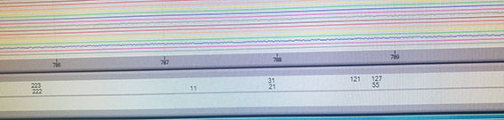

I am a psychology student from VU Amsterdam. I am conducting EEG study with BioSemi equipment recently. However, I faced some problems. When I choose the sample rate lower than 2048, such as 512, the error trigger will send. The code (python) I use to send trigger is :

You can check the figure of error trigger (actually I do not send code like 223, 31, 127):E6A00D9433FC53E8BA078050EB6F99BF.jpg
Would you please help me fix it,
Thank you everyone.

Use positive trigger logic (down-sampling uses OR function to calculate trigger of multiple samples)
Use "analog" trigger display to investigate the problem.
see viewtopic.php?f=7&t=1022
