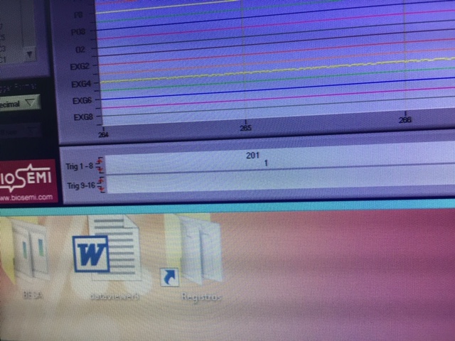

Hello, I have a problem with the triggers, I see them in the ActiveTwo but not in the registry, how can I recover them?
Thank you
In the attached image I can not see the 2
image3 (1).jpeg (126.92 KiB) Viewed 73062 times
Re: Difficulties to see the triggers
The triggers are in the last channel of the BDF file, see https://www.biosemi.com/faq/file_format.htm and https://www.biosemi.com/faq/trigger_signals.htm
