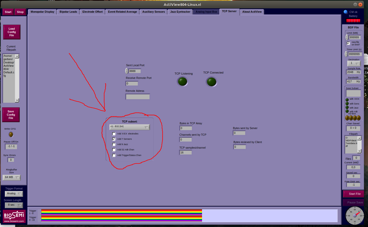

When the acquisition is not running you can select which channels you want to transmit over the tcp/ip link under the bracket "TCP subset"
How many channels did you select to be transmitted in Actiview?

I haven't encountered any selction brackets, is it something to do with the GUI in the TCPclient code? anyway I need all 64 channels(+7 for GSR).
Thanks, Dor.
Gerben
Posts: 28
Joined: Fri Sep 24, 2010 4:36 pm
Re: TCP/IP connection
Post by Gerben »
With the acquisition running you have to press stop (top left) and then select the required channels and press start again.
Screenshot from 2021-05-31 12-32-31.png (180.14 KiB) Viewed 98348 times
After that you can connect with the matlabclient.
The matlabclient should be configured to 64+7=71 channels.
Best regards
Biosemi (Gerben)

Thank you very much, you helped me a lot!
