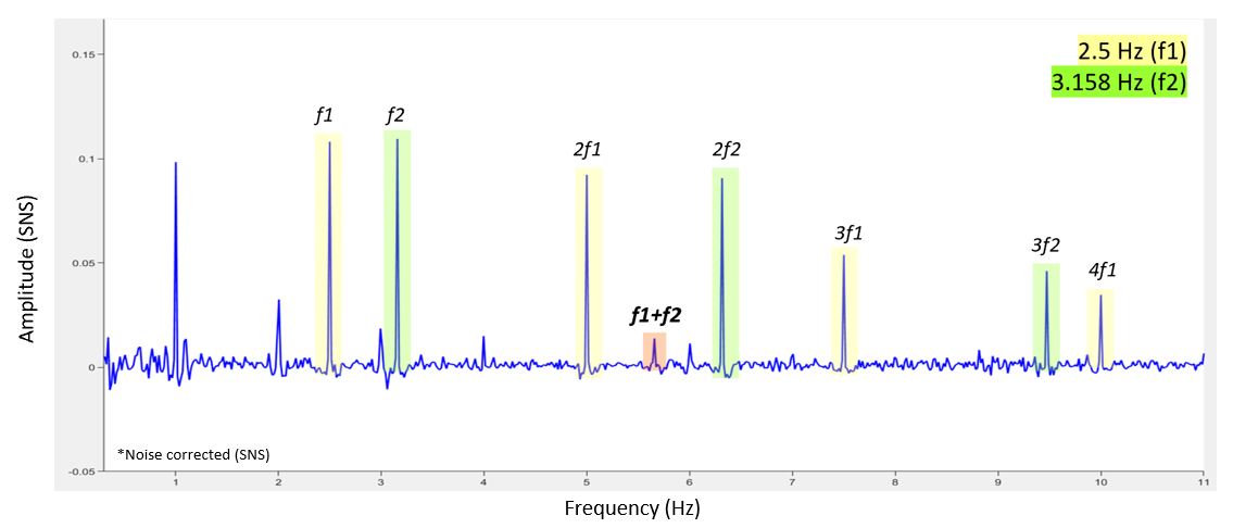

Hi there,
I am running a frequency tagging study. The paradigm involves flashing visual stimuli on the screen at 2.5 & 3.16Hz to induce periodic neural responses. I've attached the grand averaged frequency spectrum showing the responses to our stimulation (fundamentals & harmonics highlighted) as well as peaks completely unrelated to our stimulation (unhighlighted). The source appears to be at 1Hz with the rest being its harmonics. I am not sure where this could be coming from as it doesn't align with our stimulation.

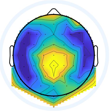

I have also included the topography of this 1Hz response which does not look visually based. It looks like it is right above CMS/DRL. Is it possible that something in the hardware is causing this?

"Is it possible that something in the hardware is causing this?"
No, the BioSemi system does not generate any signal of exactly 1 Hz.
