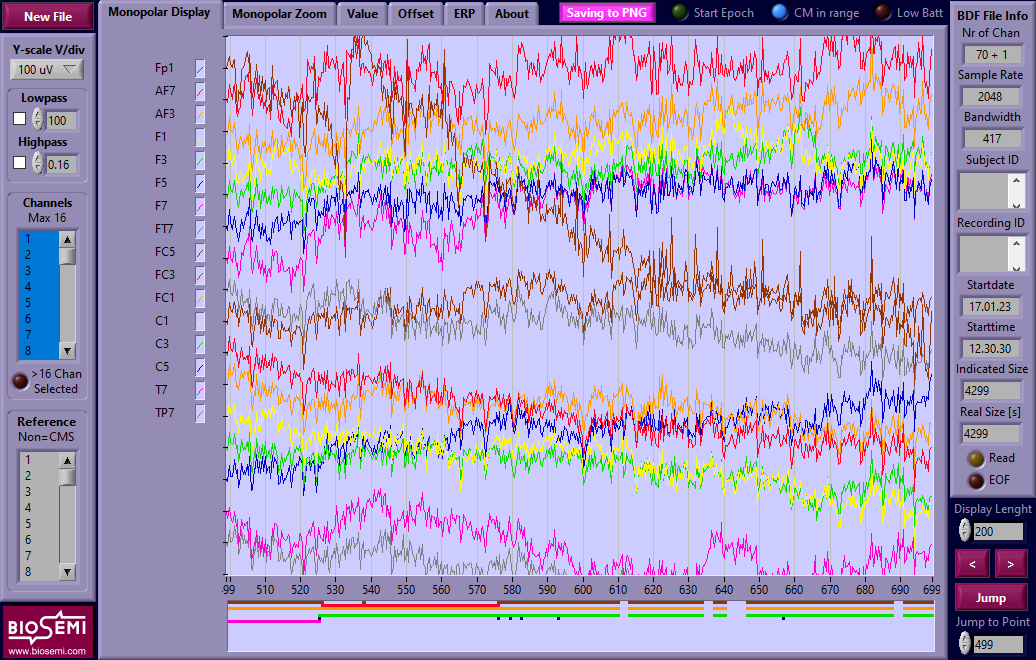

Regarding ActiRead, is there a way to see the decimal values of the triggers? I see colored lines but don't really know what they mean or how to use them to differentiate between my triggers. I am including some snap shots of the reader in a follow up comment, could you please tell me if this looks all normal?

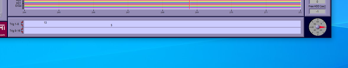

A pattern I noticed and wonder if it is at all meaningful. When sending triggers and having them displayed as decimals during recording, some appear in the upper line (e.g., 13) and some the lower line (e.g., 5 ). Those in the upper line I find back in the recording, but the lower line do not? Many thanks for helping me understand and troubleshoot.

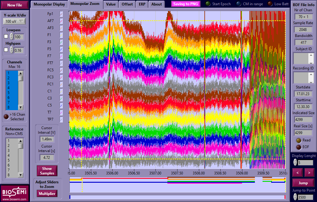

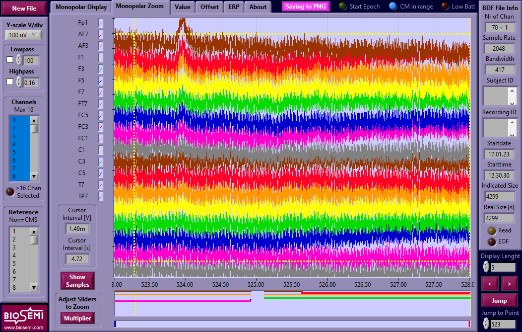

Re: Triggers show in ActiView but are missing in saved recording.
The triggers in ActiRead look as follows (note difference in display length)
The colored lines show the trigger lines 1-16 (colored when High). Use ActiTools to convert to decimal values. The errors in other file readers are because you do not pull all trigger lines Low after each trigger. In ActiRead, you should see colored dots, not lines. Use the "analog" display mode in ActiView for a similar display, see https://www.youtube.com/watch?v=0BPwcciq8u8 .
