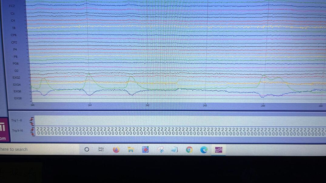

I have a problem to select status channel. During my data collection, maybe because there is something wrong in setting, Biosemi sent wrong extra triggers in the second line, please see the attachment. My correct triggers were sent correctly in the first line, but it kept sending 202020 triggers in the second line.
Now I am using MNE in python to analyze the data, but it seems that it merges the 2 lines of triggers and returns me wrong ones. I found that I can use "stim_channel" function to select. But I don't know the name of the stim channels. Could you please help with this?

See viewtopic.php?f=1&t=1236&p=3633
Edit the CFG with the "Configurator" tool in ActiTools902 ( http://www.biosemi.com/download/ToolsFo ... 02-Win.zip ).
You can remove the extra triggers with the "Muter" tool in ActiTools902
There is one Trigger/Status channel (last channel): http://www.biosemi.com/faq/trigger_signals.htm

Thank you, Coen~~ The problem is solved by using ActiTools92! It's very easy!
I really appreciate your help!
