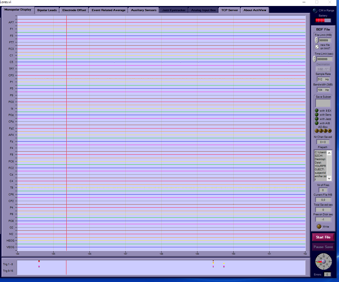

Hello, everyone,
I'm using biosemi to record EEG in my experiment. The triggers were shown at the exact timing but there was no trigger code. They were shown as small lines (cf. image below).
I''m using Presentation to present stimuli and the logfile said that all the stimuli and trigger codes have been correctly sent.
Does anyone have idea about why the trigger codes didn't show ?
Thank you in advance.
Trigger codes shown as small lines
Re: Trigger code not shown
About/Configure tab --> Trigger Format (lower left corner) --> Decimal

Hi, Coen,
Thank you very much for your reply.
I can successfully see the port codes in decimal.
