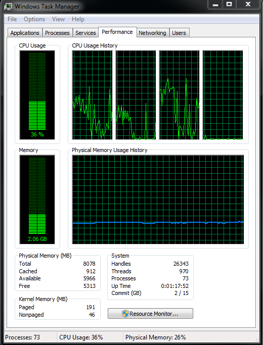

Actually, with further testing of Actiview 705, I've noticed that it's having this 5002 error intermittently just by itself (without me trying to run the motion program). It does seem to be due to lag (when I try to move the front panel, it often gives this error), but the buffer clock still is showing identical behavior.
I checked out my computer's memory while Actiview is running and it seems to be ok (please see attached image). I'm using a 64-bit Windows 7 professional. LabVIEW Run-Time-Engine is only useful if we want to run the original Actiview code without any modifications, correct? I've added some minor things into the code to trigger other programs, but I'm still experiencing this error 5002 with the original code.
Do you know of anyone else who has experienced this error with the new Actiview? Any help is appreciated.
Renee

Re: Error 5002 lagging?
A sync error (5002) is usually caused by a bad optical link or USB link (hardware problem causes intermittent data loss). Please carefully test again whether the error is linked to a certain repeatable software action in your case. If the error occurs intermittently, than a hardware problem is most likely. The reason that we discussed software issues above, is that you seemed certain initially that the error was linked to a specific software action (starting streaming of motion data). Now that this does not seem the case anymore, a hardware problem is by far the most probably cause (actually, we have not yet seen any error 5002 occurrence caused by software issues yet). Lagging problems cause a 5001 (buffer overflow) error.
The basic acquisition (and error handling) of ActiView 6.05, 7.05 and Light-6.04 is exactly the same. The code differences between ActiView 6.05 and 7.05 are very small (and everything related driver communication and error handling is the same). ActiView 6.05 loaded with ActiView 8.6.1 or higher is basically 7.05. Different behavior with respect to error 5002 is very difficult to imagine.

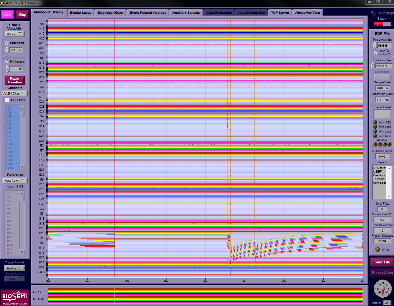

Sorry for the late reply; I got sidetracked on some other projects. I think you may have pinpointed the problem though; I'm using Labview 2012 and I tested the exe version of Actiview 7.05 under Runtime Engine 8.6.1 and that one doesn't seem to have the error 5002 or this other error I recently noticed that happens when the unmodified code is running as well (see attached image-electrodes in the G/H area appear to be coming ungrounded; this happens when no electrodes are actually attached to the Biosemi system).
I'm currently trying to obtain Labview version 8.6.1 to see if that solves the issues. I'll update here after I see how that goes.

It is extremely unlikely that the version of LabVIEW has anything to do with it. I think that it is either a hardware problem (unmodified code) or a problem with how you sent out triggers (modified code).
Your screenshot shows intermittent data loss (bad optical link, bad USB link, etc).
Best regards, Coen
Best regards, Coen
