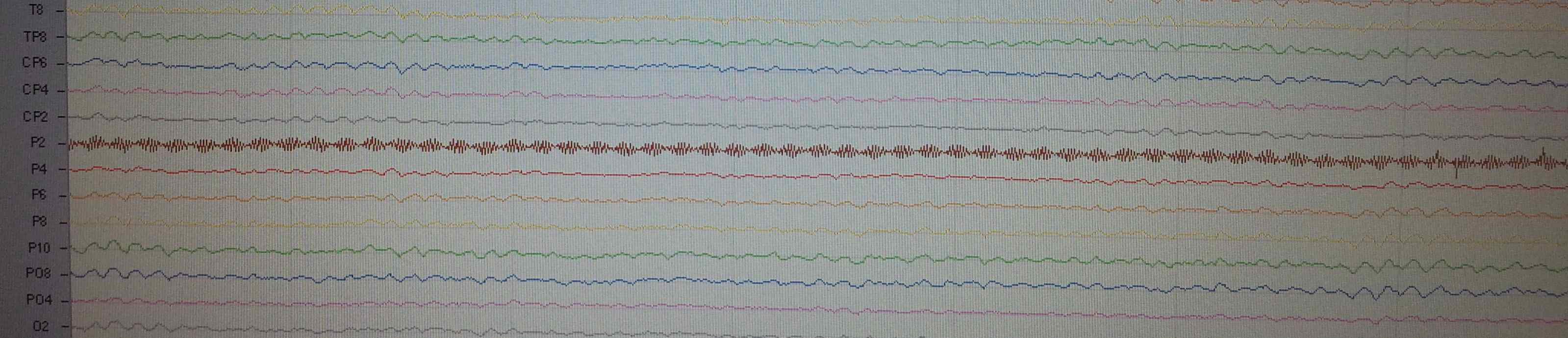

We are recording EEG using a Biosemi ActiveTwo box (64 channel cap).
All of our equipment is either new or recently repaired, so I don't think we have a technical problem. We have had several successful sessions. Every once in a while, though, we get a strange signal from one or two electrodes. I've attached a jpeg - the electrode in question is P2.
No matter what we have done, we cannot get this to go away. We have made sure that all connections are clean, that all offsets are low, that everything we can think of is controlled. Sometimes, it just goes away on its own, but it seems to take quite a while.
Any ideas? What is this? Is it a problem? If so, can it be fixed?

Gel bridge between P2 and (adjacent) DRL causes 50/60 Hz interference. Use less gel to prevent gel bridges between the electrodes.

I'm responding to this old post because we have had the exact same issue during data collection in our lab (high frequency noise in P2, almost certainly due to bridging between P2 and DRL).
I'm just wondering whether this bridging introduces noise back into the entire electrode set (due to noise from P2 being fed into DRL), or whether this problem is just confined to P2 (whereby the only solution would be to remove P2 during analysis)?
Just having some trouble conceptualizing what effect this type of bridging has on the dataset as a whole.

Only the electrode(s) shorted to the DRL are affected.
Refer to the schematic in https://www.biosemi.com/pics/zero_ref1_big.gif . A gel bridge between an electrode and the DRL can be represented in the schematic as a short between the electrode and the DRL opamp output. The DRL will still drive the subject as close as possible to the AMP/DAC reference voltage. However, the shorted electrode will now measure the Vcm (Common Mode voltage) instead of the voltage at the body surface.
From the schematic also follows:
- a gel bridge between an electrode and CMS causes a flat line (just amp noise) for that electrode in the unreferenced signal display
- a gel bridge between CMS and DRL reduces the CMRR with 40 dB at 50 Hz (equal hum on all channels)

I was wondering how problematic this issue is.
It happens to us for a decent amount of participants, yet when I look at the preproccesed data, I see that both P2 and P1 are almost never excluded. Does this mean that when we look at the data during the data collection and see these noisy/flat channels, it doesn't imply that these channels should be considered "bad'?

No, they are bad.

That is very interesting. Would you have an idea why matlab (or EEG lab) would not exclude these channels all the time then?

Is it possible that when we reference (lets say to the mastoids) in MATLAB we add this information to those flat channels? after this maybe the channels do not look flat anymore, but contain mastoid information that shouldn't be there?
Re: Strange activity on a single electrode
Certainly, if you subtract a reference from a flat channel than the result is the (inverted) reference with respect to CMS.

I know BioSemi suggests re-referencing the data (https://www.biosemi.com/faq/cms&drl.htm). Would it matter if this re-referencing happens at the beginning or later in the pre-processing pipeline? (EEGlab allows you to directly apply references to your data when you start working with a raw BDF file).
As an example, I was working on an old dataset where I wasn't sure if we had mastoid references, so I couldn't do it at the start. This made it clear how many more channels were flat that I would normally never notice. Which then made me think that it might be better to first delete bad and flat channels and only re-reference after that.
You should indeed first remove the flat/bad channels, and then reference to one or more of the remaining valid channels.

Would an average reference at this point do the same? Or does it need to be a reference to a electrode/external
You can use an average reference (from 2 electrodes to all electrodes), as long as you make sure that the average only contains good/valid channels.
