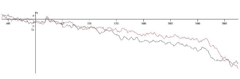

I'm doing CNV experiment and manage to obtain quite good result but I lose a lot of data due to the drifting of the active electrode. It's not a very big drifting but my baseline is not on zero and not stable. So for some stimulation, I have drifting through the positive values and the CNV activity (which should be in the negative value) is lost in this drifting. I can't take these kind of data into account.

I already use a passband filter between 0.03Hz to 30Hz. The drifting is still here.
For example, after filtering, cleaning and epoching you can obtain something like the picture below
What do you think ?

Excessive drift is usually caused by perspiration. Try organize a cool and comfortable environment for the subjects during the experiment.
