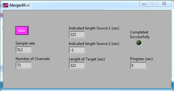

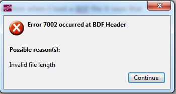

I'm trying to merge BDF files using merge86 but somehow when I load a BDF file it says that the file length is invalid (attached image).
Looking at the software, I saw that it puts -1 in the file length (attached image).
However, when I try to merge other files it works fine and when I load this file to the Analyzer it doesn't give me an error and the file is being load just fine...
Any suggestions?
Elad
Re: Merging BDF invalid
The "-1" file length indicates that the file was not closed properly during recording (crashed or switched-off computer). Use the repair tool (http://www.biosemi.com/download/ToolsFo ... pair86.zip) to repair the file.
