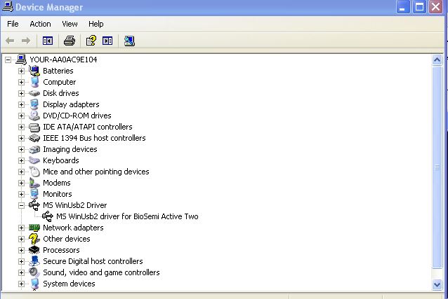

I've checked the USB is indeed a USB2, which it is (see attached pic, it doesn't appear under the USB section in the device manager - im not sure if thats an issue?), and I've tried updating the drivers, uninstalling and reinstalling them etc., I've tried replacing the labview_dll file with the 42KB version as detailed in other threads which didn't resolve the issue. I found one thread that suggested that the USB receiver may be very old and they had success with the v1.0 driver, but this didn't resolve the issue.

- Driver2.JPG (48.54 KiB) Viewed 24438 times

Error 5002 is caused by an hardware problem (unless a wrong speedmode is selected). Intermittent errors are always caused by hardware. In case of a driver/firmware/software error, restarts do not help.
Because in your case, the problems started with intermittent errors, I suspect a hardware defect. Most probably is a deteriorating optical transmitter or receiver.
Please sent the AD-box, optical fiber and USB-receiver for checking and repair.
Best regards, Coen
