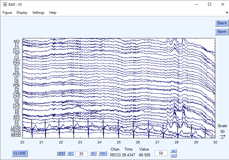

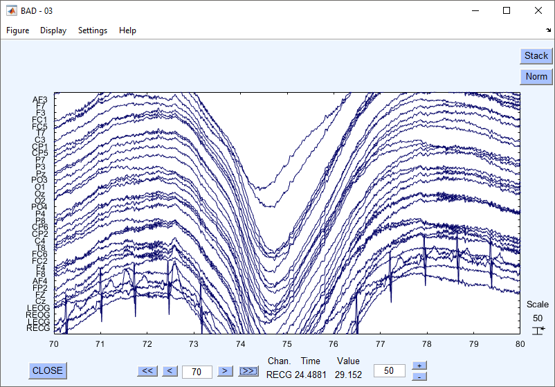

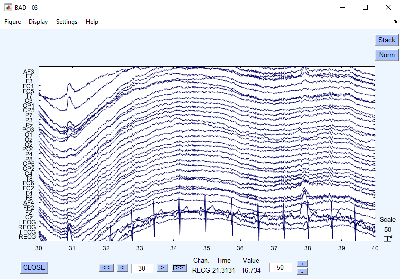

Problems:
Some slow drifts frequently occur during recording EEG, and it makes P300 classifier failed to generate feature weight.
With the same parameters, someone did not show slow drift, and someone showed slow drift over recording. There was no severe body movement during experiment (due to ear reference, all channels contain ECG component though).
Since I do not have rigorous knowledge for inspecting EEG yet, I attached picture containing drift for your help.

Re: slow drifting on EEG
Always reference the data before further processing, see https://www.biosemi.com/faq/cms&drl.htm
Raw data (with respect to CMS) is NOT valid data, do not regard or use CMS or DRL as reference. With proper referencing, location of CMS and DRL does not affect the data (but may affect interference level), also see:
viewtopic.php?f=1&t=33
viewtopic.php?f=1&t=40
viewtopic.php?f=1&t=177
